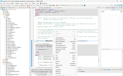

2024-11-26 6:38 AM
Hello @tejas_amp,
Architecture is described in User Manual documentation available through "Workbench tool">About>Documentations>Documentation>"User manual", "Motor Control Firmware architecture" link.
Using STM32CubeIIDE, right click on function and select "open call hierarchy".
On "Call Hierarchy", you can select "Show Callers" ot "Show Calles".
Best regards.
