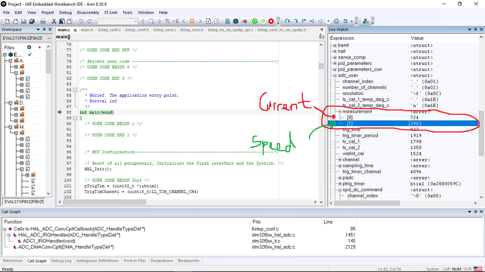

Hi All,
I am presently measuring the two signals below through a multichannel adc that is triggered by the rising edge of a PWM signal on TIM1 CH4.
a. Inverter return line current on channel 3
b. Speed reference value from a potentiometer.
I am quite sure, I am reading the right adc channel, but the problem is that the adc value for the current seems to be corrupted and it jitters too much from the correct value.
Below is the configuration code for the ADC

Also, since the application -- a bldc trapezoidal current and speed control -- I am running is kinda complex. The ADC is calibrated and started at other parts of the code.
But the main problem i think is the fact that the adc values get corrupted. I wrote another code the see the right ADC value that matches the inverter DC line current and it was totally different from what I get when I run my bldc control application.
What could possible be wrong?

The ADC of the STM32F0 contains regular channels only. So the read of two different channels in a Raw must be done with the support of the DMA otherwise the second conversion will erase the first one. I do not know if this is something you took into account.

BoboyeOkeya
October 4, 2021
Okay now I have a lot of questions, pardon me, my background is in Power electronics not embedded systems.
First, what is a regular channel? And why would the second conversion erase the first one?
I dont think it does though because I get two seperate adc values, just that the first one seems to be incorrect as shown in this picture below
Will it still be possible to trigger the ADC to start converting by using a PWM signal from another timer if I use the DMA method? I am asking because my application requires me to sample the current value only in the middle of the gate PWM signal ON-time. And the DMA method seems to continously sample at all times?
