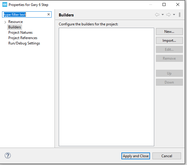

Semer CHERNI
Hello @FTrac.1​
I want to know what you mean by "The builders list" , could you provide some screenshots of the build setting menu.
This would be very helpful to better understand the situation.
Waiting for your feedback.

FTrac.1
this:

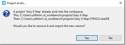

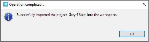

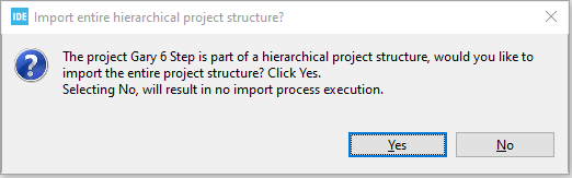

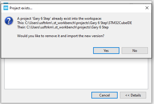

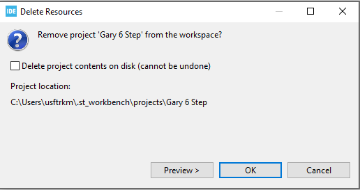

Note - I have duplicated the issue.
I went into CubeMX and made some changes, then clicked "Generate code"
When this was complete, I selected "Open project" from the CubeMX generate code which opened the project in the IDE.
The IDE popped up I think 3 modal dialogs which I clicked through - I will try to reproduce these today, but I believe it was saying that the project was hierarchical and needed to be imported. I clicked on "Yes" for these dialogs, and now the builders list is empty again. See above.
I remember doing this before, on 1.11.0.
