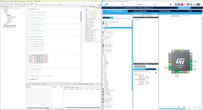

STM32CubeMX 6.14 stuck generating code & STM32CubeIDE 1.18 won't generate code
Hardware: STM32L071CZTX
Software Versions:
  • STM32CubeMX 6.14
  • STM32CubeIDE 1.18
Problem Description:

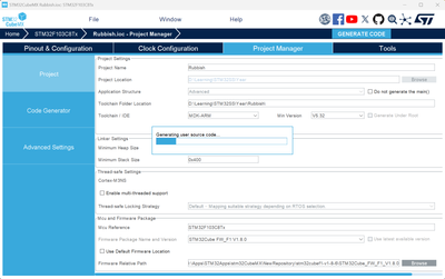

I'm experiencing code generation issues with both Cube software tools on an existing STM32L071CZTX project:
Issue 1 - STM32CubeMX 6.14:
  • Code generation process gets stuck and becomes unresponsive
  • Only way to terminate is through Task Manager (killing OpenJDK Platform binary process)
Issue 2 - STM32CubeIDE 1.18:
  • Code generation fails when modifying clock parameters
  • No code is generated after clock configuration changes
Steps Already Taken:
  • Performed complete uninstallation of all STM32 software
  • Fresh installation using newly downloaded files from ST website
  • Verified MyST account login on both applications
Request: Has anyone encountered similar issues with these software versions? Any guidance on resolving these code generation problems would be greatly appreciated.
Thank you for your assistance.

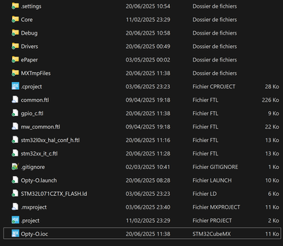

CubeIDE and CubeMX works on a fresh project
i have some .ftl files laying arount my project root, deleting them (and the MXTmpFiles) does not fix my problem. however, they come back after another generation tentative.
another test i did was to regenerate a new project from my .ioc but cubeMX was denied access to the C:/ drive
so i tried running as administrator. this fixes the issue for the new project generation but not updating my existing one.

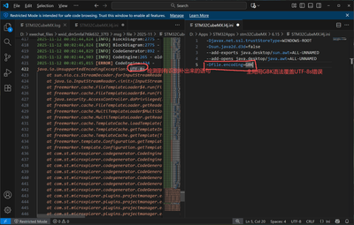

I'm experiencing a similar issue:
https://community.st.com/t5/stm32cubemx-mcus/stm32cubemx-freezes-during-code-generation/td-p/818146
I'm not sure if this is the cause of the freeze, but I found an error in the MX log.
C:\Users\<My Account>\.stm32cubemx\STM32CubeMX.log
2025-07-02 11:50:30,696 [ERROR] CodeEngine:432 -
java.io.UnsupportedEncodingException: UFT-8
at sun.nio.cs.StreamDecoder.forInputStreamReader(StreamDecoder.java:79) ~[?:?]
at java.io.InputStreamReader.<init>(InputStreamReader.java:111) ~[?:?]
at freemarker.cache.FileTemplateLoader$4.run(FileTemplateLoader.java:210) ~[STM32CubeMX.exe:?]
at freemarker.cache.FileTemplateLoader$4.run(FileTemplateLoader.java:202) ~[STM32CubeMX.exe:?]
at java.security.AccessController.doPrivileged(AccessController.java:571) ~[?:?]
at freemarker.cache.FileTemplateLoader.getReader(FileTemplateLoader.java:202) ~[STM32CubeMX.exe:?]
at freemarker.cache.MultiTemplateLoader$MultiSource.getReader(MultiTemplateLoader.java:147) ~[STM32CubeMX.exe:?]
at freemarker.cache.MultiTemplateLoader.getReader(MultiTemplateLoader.java:105) ~[STM32CubeMX.exe:?]
at freemarker.cache.TemplateCache.loadTemplate(TemplateCache.java:547) ~[STM32CubeMX.exe:?]
at freemarker.cache.TemplateCache.getTemplateInternal(TemplateCache.java:439) ~[STM32CubeMX.exe:?]
at freemarker.cache.TemplateCache.getTemplate(TemplateCache.java:292) ~[STM32CubeMX.exe:?]
at freemarker.template.Configuration.getTemplate(Configuration.java:2822) ~[STM32CubeMX.exe:?]
at freemarker.template.Configuration.getTemplate(Configuration.java:2671) ~[STM32CubeMX.exe:?]
at com.st.microxplorer.codegenerator.CodeEngine.freemarkerDo(CodeEngine.java:410) ~[STM32CubeMX.exe:?]
at com.st.microxplorer.codegenerator.CodeEngine.genCode(CodeEngine.java:271) ~[STM32CubeMX.exe:?]
at com.st.microxplorer.codegenerator.CodeGenerator.generateOutputCode(CodeGenerator.java:6373) ~[STM32CubeMX.exe:?]
at com.st.microxplorer.codegenerator.CodeGenerator.generateLicenceText(CodeGenerator.java:9717) ~[STM32CubeMX.exe:?]
at com.st.microxplorer.codegenerator.CodeGenerator.generateCodeFiles(CodeGenerator.java:1942) ~[STM32CubeMX.exe:?]
at com.st.microxplorer.codegenerator.CodeGenerator.generateDefaultConfig(CodeGenerator.java:10860) ~[STM32CubeMX.exe:?]
at com.st.microxplorer.codegenerator.CodeGenerator.generateCode(CodeGenerator.java:1583) ~[STM32CubeMX.exe:?]
at com.st.microxplorer.plugins.projectmanager.engine.ProjectBuilder.generateCode(ProjectBuilder.java:3061) ~[?:?]
at com.st.microxplorer.plugins.projectmanager.engine.ProjectBuilder.createCode(ProjectBuilder.java:2223) ~[?:?]
at com.st.microxplorer.plugins.projectmanager.engine.ProjectBuilder.createProject(ProjectBuilder.java:818) ~[?:?]
at com.st.microxplorer.plugins.projectmanager.engine.GenerateProjectThread.run(GenerateProjectThread.java:61) ~[?:?]
2025-07-02 11:50:30,702 [INFO] CodeEngine:287 - Generated code: C:\Projects\STM\test207\MXTmpFiles\license.tmp
2025-07-02 11:50:30,860 [ERROR] ProjectBuilder:2226 -
java.io.IOException: Can't delete C:\Projects\STM\test207\BSD_License.ftl
at com.st.components.util.FilesUtils.delete(FilesUtils.java:34) ~[STM32CubeMX.exe:?]
at com.st.microxplorer.codegenerator.CodeEngine.genCode(CodeEngine.java:301) ~[STM32CubeMX.exe:?]

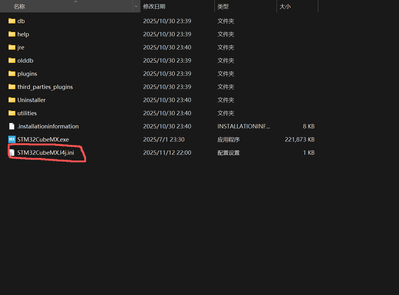

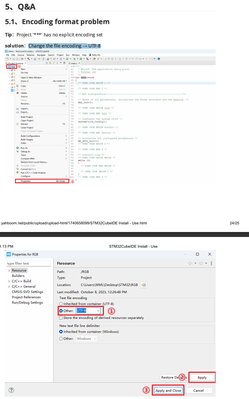

Explorer
Nov 12, 2025 3:35 PM UTC
I had the same issue for three months already, which caused my cubemx code generation malfunction. Here's the issue:
The solution: find the file on the right named below
Type in the last line.
OR: type in same line but replace GBK to UTF-8.
I don't know how exactly this problem occur. According the online information, it seemd that the compiler detect wrong code"UTR-8s", which should be "UTR-8". Here's relative information in the mannual of CubeIDE:
Explorer
Nov 12, 2025 3:39 PM UTC
