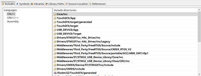

我在使用cubeide时一直报错,下面是详细的报错信息:
Description Resource Path Location Type
fatal error: SDL2/SDL_render.h: No such file or directory HALSDL2.hpp /llwstm32/Middlewares/ST/touchgfx/framework/include/platform/hal/simulator/sdl2 line 26 C/C++ Problem
make: *** [Middlewares/ST/touchgfx/framework/source/platform/driver/touch/subdir.mk:19: Middlewares/ST/touchgfx/framework/source/platform/driver/touch/SDL2TouchController.o] Error 1 llwstm32 C/C++ Problem
make: *** Waiting for unfinished jobs.... llwstm32 C/C++ Problem
'destroy' defined but not used [-Wunused-function] genx320.c /llwstm32/Drivers/product-genx-ctrl/src line 188 C/C++ Problem
Project 'llwstm32' has no explicit encoding set llwstm32 /llwstm32 No explicit project encoding
Project 'product-genx-ctrl' has no explicit encoding set product-genx-ctrl /product-genx-ctrl No explicit project encoding

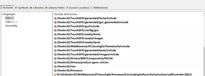

路径都添加了,不知道是什么原因引起的,使用的是STM32F7146G-DISCO

Look for the files. Do they exist? If so, are the include directories set up so it find them? Show evidence of this.
Unclear if it can't find SDL2/SDL_render.h or HALSDL2.hpp.
2025-07-05 6:59 AM
是的,SDL2/SDL_render.h 位于路径 D:\32\llwstm32\Middlewares\ST\touchgfx\framework\include\platform\hal\simulator\sdl2\vendor\SDL2 下,HALSDL2.hpp 位于路径 D:\32\llwstm32\Middlewares\ST\touchgfx\framework\include\platform\hal\simulator\sdl2 下。

Hello @Cherry猫猫 ,
What is your hardware? What are your software and versions?
Are the files located where the includes are pointing?
