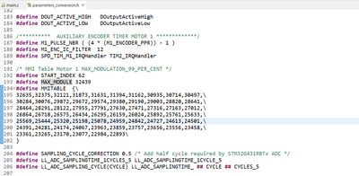

Omer Ab
@STuser2 Hi
Where can I find or monitor the modulation index value in the interface?
/* MMI Table Motor 1 MAX_MODULATION_100_PER_CENT */
#define MAX_MODULE 28000
parameters_conversion.h file
28000 i used but it can go higher as well.
Omer Ab
@STuser2
Thanks for fast reply
Max modulation value is 32,439 can we raise it even more?
The maximum is 32767 you can try over modulation. I don't know the exact root cause I am telling based on my experience so you can decide to follow or not.

Omer Ab
@STuser2 @Floflo
I tried it, but I didn’t notice any difference.
