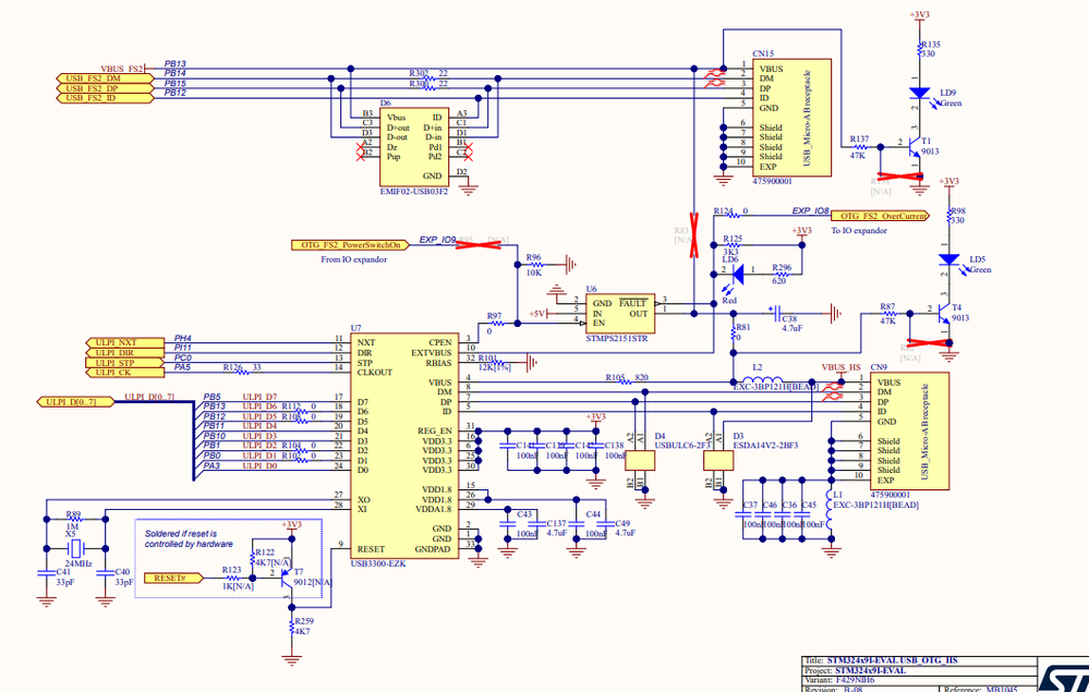

I have connected and an external HS PHY to STM32F427VGT6 through ULPI pins.
Configured USB_OTG_HS in Host Only mode for external Phy with parameter Settings as
Speed: High Speed 480MBits/s
Enable internal IP DMA: Disabled
Physical Interface: External Phy
Use External VBUS: Enabled
Signal Start of Frame: Disabled
In NVIC settings for USB_OTG_HS all three available interrupts are enabled.
USB On The Go HS End Point 1 Out global interrupt true 0 0
USB On The Go HS End Point 1 In global interrupt true 0 0
USB On The Go HS global interrupt true 0 0
In Middleware Packages USB_ Host, FATFS is configured according to attached image.
MCU schematic and USB-PHY schematic is also attached.
The problem i am facing is STM32 is not detecting USB and gstate of USB always remain to HOST_IDLE, even if i connect or disconnect pendrive.

Hi @embedded-jsd
Would you attach your IOC file?
Check this schematics using STM32F429.
To give better visibility on the answered topics, please click on "Best answer" on the reply which solved your issue or answered your question.Best regards,FBL
January 30, 2026
There are two differences in my schematic:
1. 10K pull up to 5V on EXTVBUS line.
2. ID pin of USB3300 is connected to GND.
I have also attached the ioc file of my project.
February 2, 2026
Hi @embedded-jsd
Also, NXT and DIR are assigned to PH4 and PI11 respectively. But this is not the issue.
At this stage I would focus more on confirming with a scope or logic analyzer that:
  • ULPI_CK (PA5) runs at 60 MHz.
  • DIR, NXT, and D[0..7] toggle when a device is plugged.
You can test the example provided in CubeF4 for high speed instance.
