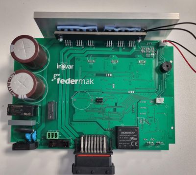

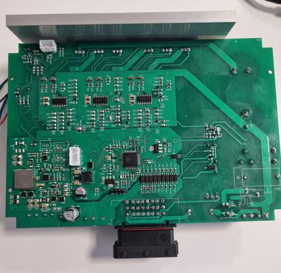

KEREM_TOPCU
Hello @Floflo
As our software manager @Omer Ab  wrote before, we need to increase the motor speed to around 80 Hz. The motor used in the project can operate at high speed, there is no problem with the hardware or mechanics.  We will increase the motor speed to the highest level and start mass production of the device. I am sharing the final photos of the device below. Our device needs software support. Thanks
