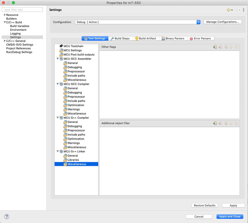

Now I receive the error every time, even in new project.
I'm not able to remove those flags as recommended by Daniel, because I don't see them in that place. Please see below screenshot:
Any idea what is causing the issue and how to fix it? I can share the project if it will help.
I'm using:
macOS Catalina
Cube IDE 1.6.1
Nucleo-H723ZG
target language: C++
DPiór.1
I found a way how to remove those flags. I just can remove them directly from .cproject file.
Unfortunately I still didn't find the rule for this issue. In most cases it happens after editing .ioc file in CubeMX, but not always.
