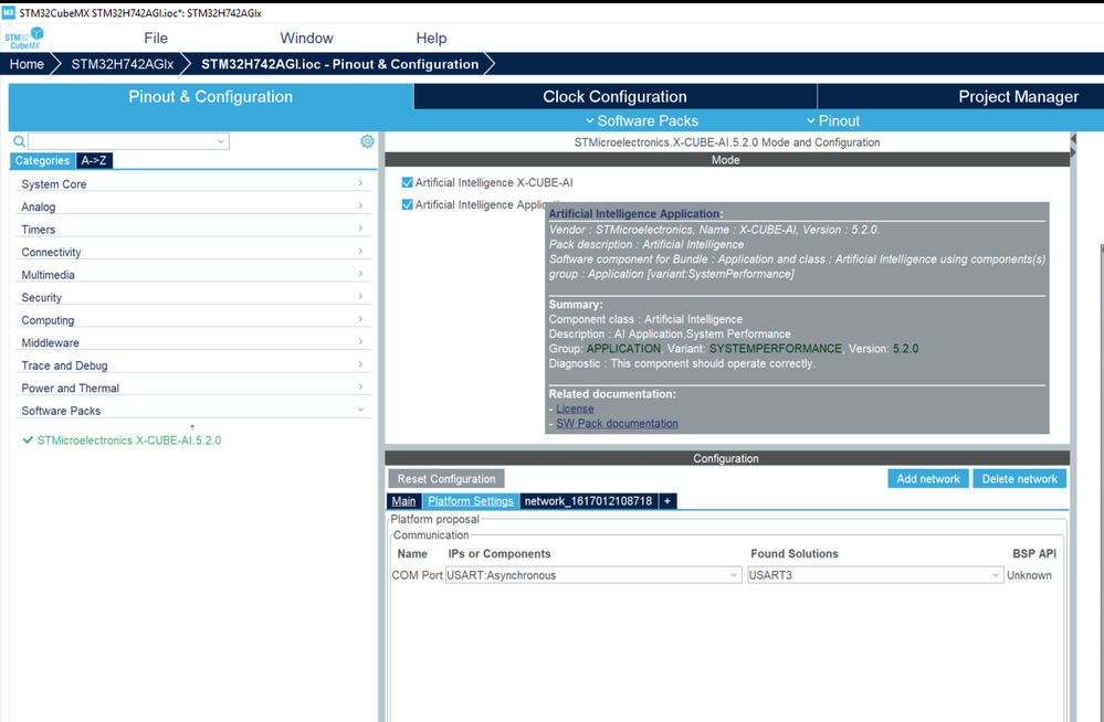

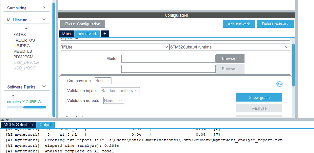

I am trying to generate the code for a neural network with STCubeMX, and I'm following the manual you have posted here (https://www.st.com/resource/en/user_manual/dm00570145-getting-started-with-xcubeai-expansion-package-for-artificial-intelligence-ai-stmicroelectronics.pdf). I follow all the steps, but, when I have to select the USART3 on the "Platform Settings" configuration tab of X-CUBE-AI, there is no "Plarform Settings" tab. I attach some images.

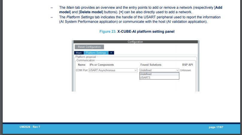

This is how it is supposed to be:
This is what I have:

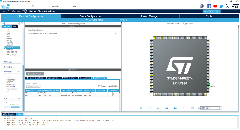

 As you can see, the USART3 is correctly configured:

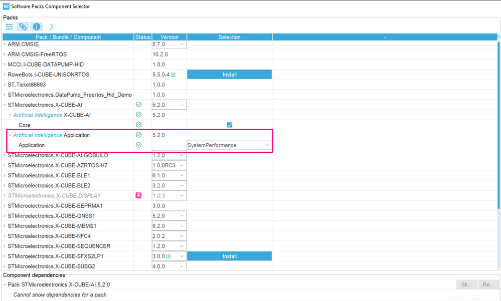

To select the USART3 on the "Platform Settings" configuration tab of X-CUBE-AI, you need to select SystemPerformance for Application component in Software Packs Component Selector .
0693W000008yQVMQA2.pngFor more details please refer to SW Pack documentation available from STM32CubeMX TAB configuration.

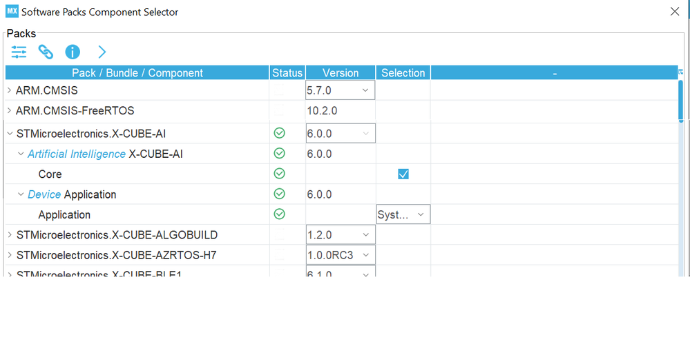

I'm using X-cube-ai 6.0.0, I cannot see Artificial Intelligence Application, only core, (see the screenshot below). Your version is 5.2.0, I don't know if that matters. Please advise how I can resolve this issue.

Hi @GWang.3​ ,
If I well understand you are not able to found Artificial Intelligence Application component in Software Packs Component Selector , is it correct?
Or may be you mean it is not available in Software Packs TAB in Pinout &Configuration TAB?
I tried with X-Cube-AI 6.0.0 and it is OK also, please tell me if the Device application is available under X-Cube-AI as in the screenshot below:
0693W000008yVh8QAE.pngHouda
Hello Houda,
After several trial and error, (remove everything, install AI 5.2.2, and then 6.0.0), finally it is working as expected.
Thanks,
Guoping
