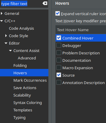

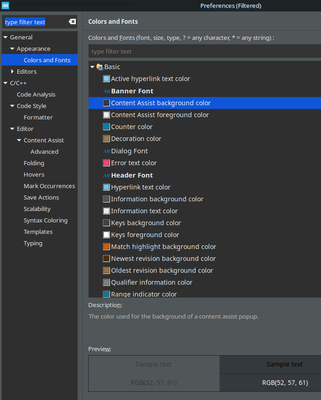

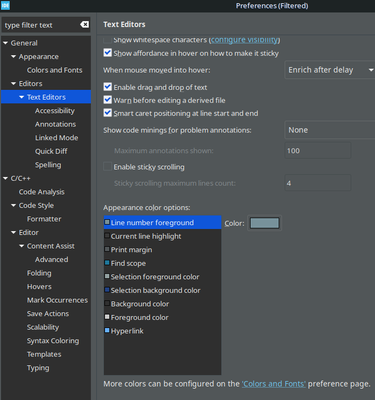

there are so many elements to choose, just try yourself, to get the colors you like:
right click in editor window -> preferences
you see:
- or

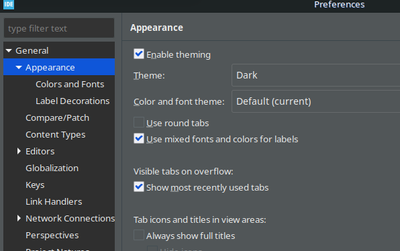

in menu : Window -> Preferences -> General -> Appearance
+ on some colors/settings , IDE needs restart, to get all colors set .

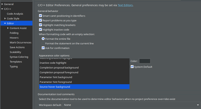

maybe : source hover -> my setting
‎2025-05-22 1:27 PM
Editor->Source hover background and tick on <system default > worked
That solved my issue.
