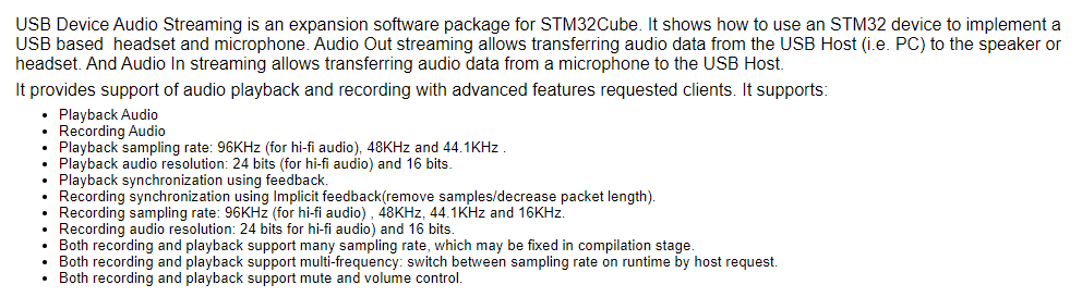

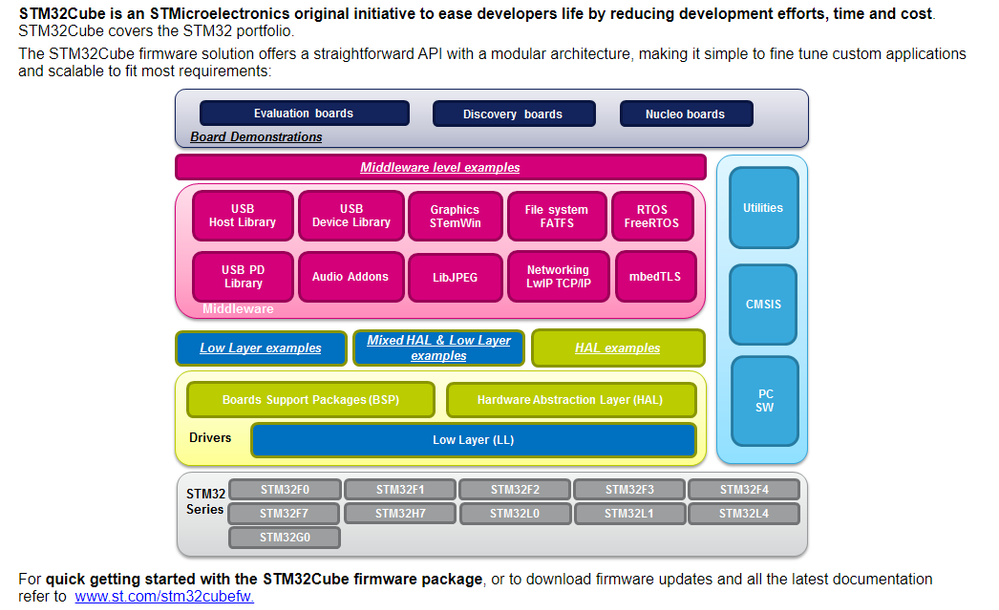

0693W00000FAzDQQA1.png0693W00000FAzDVQA1.pngHi Javier,
The audio rate is 24 bits and 96K Hz.
The X-Cube-Audio release node has the following massage:
The playback support 24 bits and 96KHz, but we don’t know if the full series of MCUs supports.
im a bit confused, are you mixing software packages?
  • The USB device streaming , that seem the one youre taking the captures from?
  • X-Cube-Audio clearly says only chips from families f4 and f7 supported.
Available for consulting/freelancing , hit me up in https://github.com/javiBajoCero
By the way, UM1995 section 4:
CDC libraries are built to run either on a Cortex® M4 or on a Cortex® M7 core, without FPU usage. They can be integrated and run on corresponding STM32F4/STM32L4 or STM32F7 family devices. There is no other hardware dependency.
