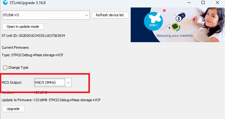

As you have the same Clock configuration in both projects and as USART is working with HSI, I'm suspicious about the clock configuration you set for the STLINK. In CubeMx HSE= 5MHz, but is it really fed by 5MHz in OSC_IN pin from STLINK?
Could you please double check whether you set the correct MCO output clock (5MHz) for STLINK using CubeProgrammer? (refer to How to use STLINK-V3 MCO output on Nucleo boards as a precise clock source for STM32)

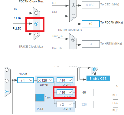

PS: for CAN, increase the Kernel clock to 40MHz as shown below

Right, I've applied your changes to my FD CAN clock running at 40 MHz (though I'm a bit confused: I set my PLL Source MUX to HSE, but then I select PPLL1Q as the input to my FDCAN ? Sorry if I'm missing something, but I'd appreciate some clarification if possible).
Also, when I open SM32Cube Programmer and click on ‘Firmware Upgrade’, I get this and nothing else; I don’t think that’s normal, but perhaps I’ve simply forgotten to configure something...
Thank you very much for your help,
Did you check the ST-LINK MCO output settings using CubeProgrammer as I suggested previously?
