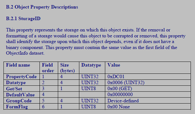

Problem:
In the original ST example, the following function is used to return all object handles to the host:
  * @brief  Object_GetHandlesIndex
  *         Get all object handle.
  * @PAram  Param3: current object handle
  * @PAram  obj_handle: all objects handle files in current object
  * @retval number of object handle in current object
ULONG Object_GetHandlesIndex(ULONG Param3, ULONG *obj_handle)
  UINT index;
  ULONG object_handle_num = 0;
  if (Param3 == 0xFFFFFFFF)
    for (index = 0; index < MTP_MAX_HANDLES; index++)
      if (ObjectHandleInfo[index].object_handle_index != 0)
        obj_handle[index] = ObjectHandleInfo[index].object_handle_index;
    /* Return number of object in Root folder */
    object_handle_num = object_handles_counter;
  return object_handle_num;
This implementation returns all objects when Param3 == 0xFFFFFFFF (root).
However, the issue is that Windows displays all files as if they were located in the root directory, ignoring the folder hierarchy.
Attempted Solution:
To address this, I modified the function as follows:
  * @brief  SD_Object_GetHandlesIndex
ULONG SD_Object_GetHandlesIndex(ULONG Param3, ULONG *obj_handle)
  UINT index;
  /* MTP usa 0 o 0xFFFFFFFF para referirse a la raíz (Root) */
  ULONG target_parent = (Param3 == 0xFFFFFFFF) ? 0 : Param3;
  for (index = 0; index < SD_MAX_HANDLES; index++)
    /* Filtro: El objeto debe existir Y su padre debe ser el solicitado por el PC */
    if (SD_ObjectHandleInfo[index].object_handle_index != 0 &&
        SD_ObjectHandleInfo[index].object_property.object_parent_object == target_parent)
      obj_handle[object_handle_num] = SD_ObjectHandleInfo[index].object_handle_index;
      object_handle_num++;
The idea is to:
  • Filter objects based on their parent (object_parent_object)
  • Return only the handles that belong to the directory requested by the host
I also take into account that MTP uses:
  • 0 or 0xFFFFFFFF → root
I implemented this approach based on the TinyUSB MTP example, where object handles are also filtered by parent to represent the directory hierarchy.
Although TinyUSB is a different middleware, both implementations rely on the same MTP protocol. Therefore, the underlying logic for handling object hierarchy should, in principle, be the same.
Initial Assumption (Incorrect):
I initially assumed that when navigating into a folder from the Windows Explorer:
USBD_MTP_GetObjectHandles would be called again
The host would request the handles corresponding to that specific folder
However, based on my observations, this is not how it actually works.
Current Behavior:
  • If I return all handles in the first call (Param3 == 0xFFFFFFFF):
    → All files are visible, but without hierarchy
  • If I filter by parent (current implementation):
    → Only root files/foldes are visible
Main Question
How should GetObjectHandles be properly implemented in MTP so that Windows correctly displays a hierarchical folder structure?
I tried to read the Media Transfer Protocol v1.1, but I couldn’t find anything clearly useful for my case, probably due to my inexperience with this topic.

esxu
The problem occurs because there is a bug in the ST example, which contains an error causing the StorageID property description to be incorrect.
In the USBD_MTP_GetObjectPropDesc function, in the case UX_DEVICE_CLASS_PIMA_OBJECT_PROP_STORAGEID:
/* Fill MTP object property struct */
MTP_ObjectPropDesc.ObjectPropertyCode = UX_DEVICE_CLASS_PIMA_OBJECT_PROP_STORAGEID;
MTP_ObjectPropDesc.DataType = UX_DEVICE_CLASS_PIMA_TYPES_UINT16;
MTP_ObjectPropDesc.GetSet = UX_DEVICE_CLASS_PIMA_OBJECT_PROPERTY_DATASET_VALUE_GET;
MTP_ObjectPropDesc.DefValue = (uint8_t *)&storageid;
MTP_ObjectPropDesc.GroupCode = 0U;
MTP_ObjectPropDesc.FormFlag = 0U;
It is necessary to change:
to:
MTP_ObjectPropDesc.DataType = UX_DEVICE_CLASS_PIMA_TYPES_UINT32;
This was causing MTP to not recognize my storage correctly, and therefore it could not detect that the storage had a hierarchical structure.
The correct way to describe this parameter is specified in the Media Transfer Protocol Specification Revision 1.1 (April 6, 2011), Appendix B, section B2.1.
