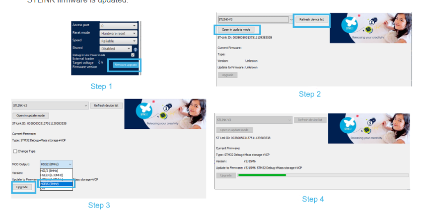

I'm trying but as shown in my previous post, I don't get the same thing as you in STM32 Cube Programmer
@AmGo wrote:
Also, when I open SM32Cube Programmer and click on ‘Firmware Upgrade’, I get this and nothing else;
Please review the article again. I think you are not following the details.
You need to click "Open update mode" as indicated in the Step 2 shown above.
  • Step 1: Open the STM32CubeProgrammer tool and click the [Firmware upgrade] button.
  • Step 2: A new window is opened. Click on [Refresh device list]. STLINK ID needs to be displayed under the button [Open in update mode]. Then click on this button to let STLINK enter the upgrade mode.
  • Step 3: In the [MCO Output] menu, select the needed frequency and click [Upgrade] button.
  • Step 4: The upgrade will start and the STLINK LED is blinking. Wait until the progress bar reaches 100%. The STLINK firmware is updated.

Please stick on the STLINK-MCO output problem for now.. Most probably the MCO output is not set to 5MHz as it should.
AmGo
Sorry, I was just answering to Andrew.
I've retried the configuration and now I can see MCO Ouput. You were right, I've changed it to HSE/2 to HSE/5.
Does it work after this change?
AmGo
Yes, it looks like.
Thank you very much.
