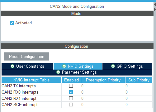

Two STM32F4-discovery boards unable to communicate over CAN
Rde K.1
I am new to HAL libraries and currently working on a small CAN bus consisting of two STM32F4-discovery boards connected to a CAN transceiver connected to the bus. Both transceivers are externally powered with 5V.
So far, I tried the existing CAN examples from the STM32CubeF4 github. The loopback example works fine, the normal mode example does not.
After a few transmissions the mailboxes are filled and the transmit function returns an error. And I can't figure out why it does not transmit the requests. Below you can find the code I on both discovery boards. It is basically the Networking example but with some light adjustments for LED output pins.
Any ideas on why this might not be working as expected?

@Community member​ When you say "will never get any messages" is incorrect. Here is a video of me using a STM32F407-Discovery board using CAN2 and no CAN1. When I use my suggested sFilterConfig without the Filterbank parameters, it works.
https://youtu.be/S-Jb2y6rdW8
@Rde K.1​ I'm not sure if you used STM32CubeIDE or CubeMX to set up the dev board, but did you enable CAN2 RX0 Interrupts?

I don't know what you did from your side. The screenshot you provided don't show the filter config. From my side I've just did a test with CAN2 and I confirm what I've already said.
If the filter bank is not well configured as I mentioned i.e. .FilterBank should be always >= .SlaveStartFilterBank for CAN2 you never get any message into the FIFO even the filter is configured to receive all IDs.
What I did: I used two boards STM32F743_EVAL and STM32F429_EVAL with the examples "Examples\CAN\CAN_Networking" provided under the respective CubeHAL driver packages, modified the example STM32F429 to receive CAN messages over CAN2, connected CAN2 to the available transceiver on the board (PA12 connected to PB13 / PA11 connected to PB12).

-> Here .FilterBank < .SlaveStartFilterBank and I never get any message because this doesn't allows you to receive any message even the CAN peripheral acknowledge the CAN frame on the bus but the frame will never get into the FIFO.

-> Here .FilterBank > .SlaveStartFilterBank and I receive well the messages sent by STM32F743_EVAL board and the LEDs are turning on according to the received message.
So please re-check from your side.
If you want I can attach the examples (F7/F4) to check.

@Community member​
By commenting out the lines .FilterBank and .SlaveStartFilterBank don't allow you to receive any messages because the default value in CAN_FMR register of CAN2SB = 0xE =14. I've already tested it with STM32F407-Disco board in loopback mode and didn't get any message with the two lines commented out. So now, I have a doubt about the authenticity of your STM32 chip.
So please use the CAN filters as described above.
