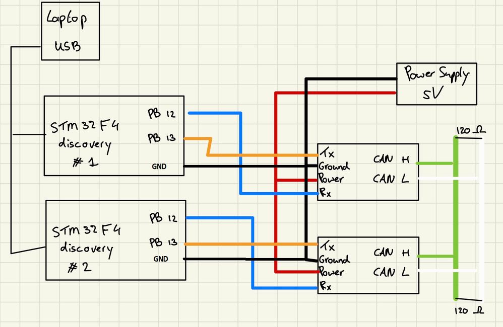

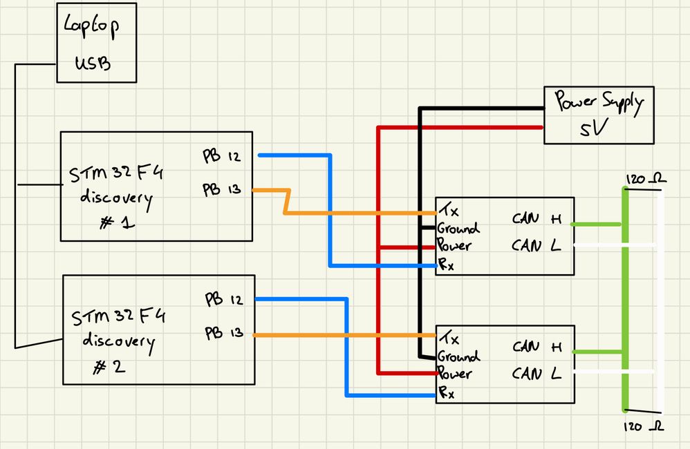

I am new to HAL libraries and currently working on a small CAN bus consisting of two STM32F4-discovery boards connected to a CAN transceiver connected to the bus. Both transceivers are externally powered with 5V.
So far, I tried the existing CAN examples from the STM32CubeF4 github. The loopback example works fine, the normal mode example does not.
After a few transmissions the mailboxes are filled and the transmit function returns an error. And I can't figure out why it does not transmit the requests. Below you can find the code I on both discovery boards. It is basically the Networking example but with some light adjustments for LED output pins.
Any ideas on why this might not be working as expected?

You need a ground reference connected from the PS/CAN transceivers to the Discovery board.

Thanks for helping @Community member​ @Community member​ . It looks like this common ground issue solved the transmission part. I can now see CAN messages on the bus using the oscilloscope.

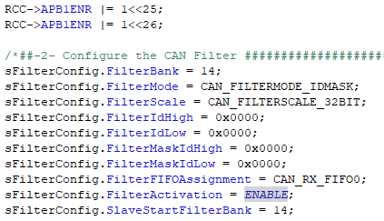

@Community member​ Thank you for the clear explanation. I changed the filterbank to 14 and explicitly enabled APB1 clock for both CAN1 and CAN2, as can be seen in the screenshot. This might have been the problem together with the common ground issue for the transmission.
However, now the Rx interrupt function is not being called when receiving a message. Any ideas on why that might not be working?
