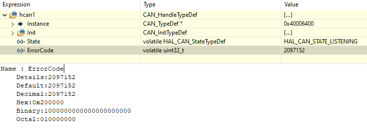

I am new to HAL libraries and currently working on a small CAN bus consisting of two STM32F4-discovery boards connected to a CAN transceiver connected to the bus. Both transceivers are externally powered with 5V.
So far, I tried the existing CAN examples from the STM32CubeF4 github. The loopback example works fine, the normal mode example does not.
After a few transmissions the mailboxes are filled and the transmit function returns an error. And I can't figure out why it does not transmit the requests. Below you can find the code I on both discovery boards. It is basically the Networking example but with some light adjustments for LED output pins.
Any ideas on why this might not be working as expected?

6 replies
After how many, always the same number? is that number 3?
hit me up in https://www.linkedin.com/in/javiermuñoz/
Rde K.1
Rde K.1Author
December 21, 2022
Yes, this is always the same number. After 32 messages, this errorcode occurs in the can handler.

mƎALLEm
December 22, 2022
It will not work as there is an issue with your filter config:
- For CAN1: .FilterBank should be always < .SlaveStartFilterBank.
- For CAN2: .FilterBank should be always >= .SlaveStartFilterBank.
I 've explained with more details in the attached .txt file how the filters are shared between CAN1 and CAN2.
Also don't forget to enable CAN1 APB clock (explanation in the txt file) even it's not used in your application.

mƎALLEm
December 22, 2022
Other points to check :
  • What is the voltage level of VIO pin of your transceiver TJA1051T/3? From the datasheet page 8: VIH min = 0.7xVIO. So if VIO = 5V. VIHmin = 5Vx0.7 = 3.5V! But your STM32 VDD= 3.3V < 3.6V!
  • Try to minimize the CAN prescaler value (.Prescaler) and maximize as much as possible the values of TimeSeg1 and TimeSeg2 and keeping your exact bitrate.
