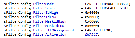

@Rde K.1​ You're not filtering on any ID's so you're receiving all CAN message so the filter bank doesn't matter. Below configuration is what I use for both CAN1 and CAN2

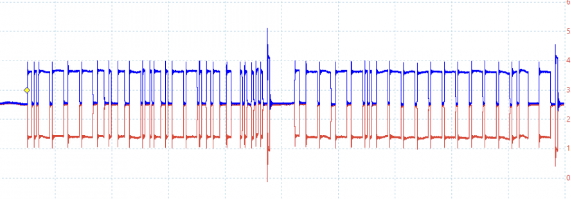

@Rde K.1​ Offhand the Auto Transmission signal doesn't look right but I'm not sure since the timebase is too fast. Can you change the timebase to closer to 1ms or so we can see as much of the signal as possible? The signal should look similar to this where you can distinguish the bits
