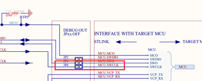

I have an STM32C092RCT6U development board and I am trying to perform UART-based bootloading. My board has a B3 button for selecting the boot mode. I am using the Flash Loader Demonstrator to flash the application, but I keep getting the following error:
“No response from the target, the bootloader cannot be started.”
I also tried using STM32CubeProgrammer. I configured it for UART and attempted to connect, but the connection fails with the error:
 “Activating device: KO. Please verify the boot mode configuration and check the serial port configuration. Reset your device and try again.”
I am using a USB-to-UART module connected to PA10 (RX) and PA9 (TX) with the lines crossed (TX→RX, RX→TX).
I also tested using inbuilt Virtual COM port, However, the device is unable to communicate and does not enter the bootloader.
Could you please help me resolve this issue?
Ok try to disconnect STLINK from the target MCU:
By removing JP4 (UM3353:(
From the board schematic:
Removing JP4 disconnects SWCLK from STM32C092.

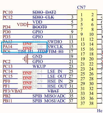

And you need to solder the solder bridge SB14 to connect the BOOT0 pin to CN7 connector.

In my board only one pin is available for boot (i.e. BOOT0), which is having dual functionality BOOT and SWD_CLK. Even after trying the standard process for boot mode, It failed to detect the device through UART.
