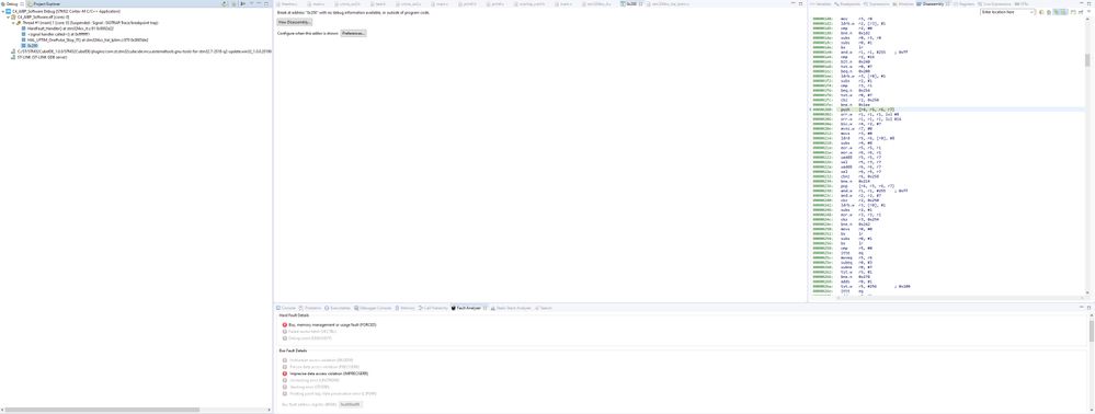

thanks for your answer. i am not shure how to do this properly. Can you give me some advice how to track that error down? As I have checked the memory map the region from 0x0010 0000 to 0x0800 0000 is reserved, that is what you meant, right? I suppose only increasing stack and heap size doesn't solve this, right?
Maybe I did a notation error, since PC in the screenshot says 0x8405e2a... ?

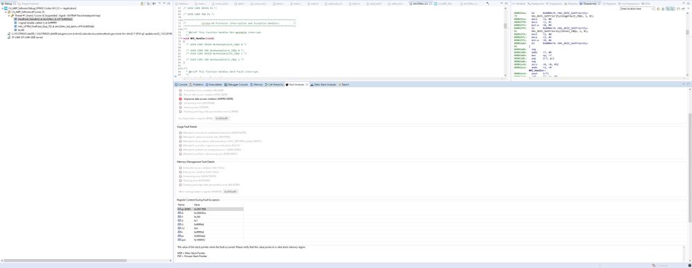

Ah.. I managed to force another hardfault. This time an imprecise data access violation:
when i click on "openeditor on fault location" I jump to the following code from the HAL_LPTIM_OnePulse_Stop_IT(..) function:

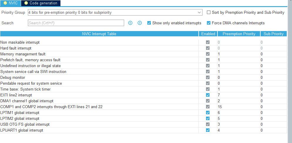

might this be a problem with interrupt priority? This is my NVIC setting:
‎2020-01-22 8:10 AM
Probably not your NVIC priorities, unless the actual issue is something like a memory management fault when you were already in the hard fault handler or debug monitor.
Where does "jump to the LR" come into play? At the end of that function as the return? The source line you show doesn't (shouldn't) have any kind of jump. When you are in the debugger after the fault, you can inspect the variables in the various functions up and down the call chain. So look at "hlptim" and see if it actually points to one of your lptim1 or lptim2 structures. You may also need to look at the previous line of code.
Now that I look again, the call chain looks a bit suspicious as it lists only "0x200" as the function that was running before the HAL_LPTIM_OntPulse_Stop_IT() function was called. It has been a while since I've looked at call chain info from a fault handler, so I don't remember is that is normal. It is NOT normal if I set a breakpoint in an interrupt function - I can see the entire call stack from main() up through the interrupt/signal handler call and interrupt functions. So this may indicate an issue before the timer interrupt fired.

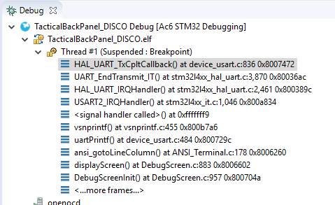

No,
The "0x200" that I am talking about is the one in the "Thread #1" call stack in the "Debug" tab in the upper left of the screen shot. There should be a function name there, Well, actually there should be something like "<signal handler called...>" BELOW (i.e. before) the HAL_LPTIM_OnePulse_Stop_IT() is shown, and then a function name below that. Something like this:
Note the <signal handler> line just before USART2_IRQHandler(). In fact, just like the UART code in my example shows USART2_IRQHandler(), then HAL_UART_IRQHandler() then UART_EndTransmit_IT(), I would expect to see in your case something in your case like LPTIM1_IRQHandler(), then HAL_LPTIM_IRQHandler(), and *THEN* the call to HAL_LPTIM_OnePulse_Stop_IT().
The register contents shown in your screen shot are practically useless without the context of the code that was running when the hard fault occurred (which is not shown). You should be able to click on a function name in the call stack ("Debug" tab in upper left of your screen) and have the IDE jump to that line. You can then examine the contents of the variables used in that function by hovering over them. Do that and see what the contents of the "hlptim" variable is in the HAL_LPTIM_InePulse_Stop_IT() function.

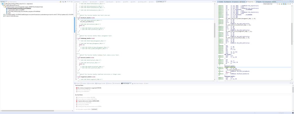

‎2020-01-23 8:27 AM
i amanaged to force the error again:
but I don't know what this is telling me about the error..
when I click on 0x200, I get the following screen:
‎2020-01-23 10:01 AM

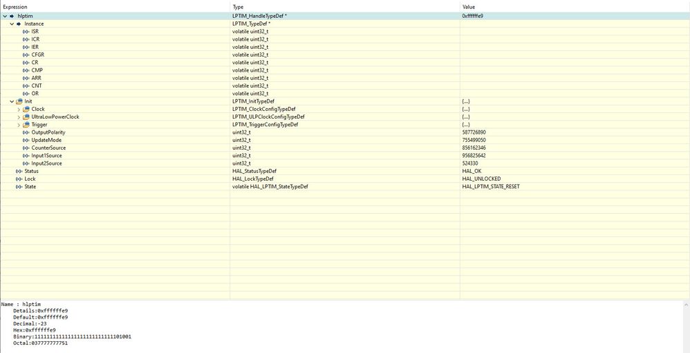

My LPTIM_HandleTypeDef handles have the following values:
hlptim1.instance = 0x40007c00 / resides in RAM at 0x20003094
hlptim2.instance = 0x40009400 / resides in RAM at 0x200038cc
When the hardfault occurs, and this only happens sometimes if I have measurements running and do attach the USB cable, the local LPTIM_HandleTypeDef handl has the value 0xffffffe9 but I cannot see values inside the .instance struct:
The fault allways occurs at the same code line in HAL_LPTIM_OnePulse_Stop_IT(LPTIM_HandleTypeDef *hlptim), which I allready mentioned:
/* Change the TIM state*/
hlptim->State = HAL_LPTIM_STATE_READY;
So am I making the correct assumption that this suspicious address of 0xffffffe9 for the local handle is not good?
