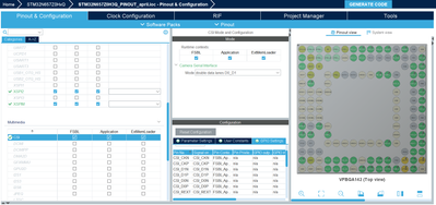

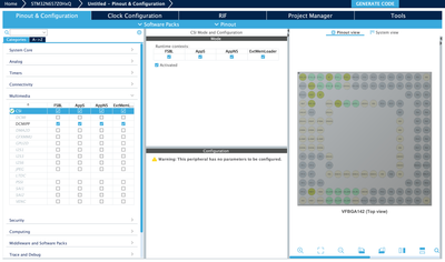

We are using the STM32N657Z0H3Q (142-pin TFBGA package).
CSI behavior in STM32CubeMX is inconsistent across versions:
  • In older CubeMX versions(1.64), CSI lanes (CSI_D0P/N, CSI_D1P/N, CSI_CKP/CKN, CSI_REXT, etc.) are displayed in the Pinout view, but these signals are not actually assignable to physical pins. They appear as virtual pins only.
  • In newer CubeMX versions(1.65), CSI is still listed in the peripheral view, but no CSI lane pins are shown at all.
In case, the generated .ioc file contains only virtual signals:
VP_CSI_VS_CSI.Mode=CSI
VP_CSI_VS_CSI.Signal=CSI_VS_CSI
VP_DCMIPP_CSI.Mode=SerialInterface
VP_DCMIPP_CSI.Signal=DCMIPP_CSI
On hardware, when connecting a CSI-2 camera, the following is observed:
  • DCMIPP and CSI registers initialize correctly,
  • no LP-to-HS transition on the supposed CSI pins,
  • ClkAct remains at 0,
  • CSI interrupts never trigger.
This behavior strongly suggests that the CSI-2 D-PHY pins are not bonded out on the STM32N657Z0H3Q package, even though CubeMX and the datasheet ballout diagrams appear to indicate CSI signals.
Questions / Clarifications Needed:
  1. Is CSI-2 (D-PHY) physically bonded on the STM32N657Z0H3Q (142-pin) package?
  2. If CSI-2 is only exposed as a virtual peripheral on this package and no pin assignment is possible, how is the CSI interface expected to be configured or used on this device?
  3. If CSI-2 is not available on this package, please confirm which orderable part numbers or package variants support CSI-2 with bonded D-PHY lanes.
  4. If CSI is not supported on the 142-pin package, CubeMX and the datasheet should reflect this to avoid confusion.
