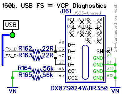

We use the USB purely for UART style diagnostics, our product is select powered, so we ignore all the power signals on USB-C and connect only DP,DN,GND - Works great and can allow faster serial diagnostics that typical UART (depending on system clocks).

We use USBC connectors for VCP for diagnostics (not for connection by customer).
No Power (No VBus), just USB2 D+/D-. The USBC is nice as cables common and can be plugged in mirrored.
Note: See other posts about handling baudrate settings and the like in ST code, otherwise some PC com programs won't connect properly.
TeraTerm, and Recently CoolTerm do work.
Note the VCP isn't available immediately at bootup, so may need to delay any critical messages till VCP is up and running.
You can get right angle USBC connectors that only have USB2 pins, easier layout with less pins.
If you want USB power look for appropriate ICs, some ST Demos have such circuits.
If planning to include as a production connection best to include ESD protection as direct MCU pins on connector exposes MCU to ESD.

You can use the HS port for this.
I suggest you get a Nucleo or other demo, and attach a USBC socket with wire leads and try it.
This USBC connector has only USB2 pins so easier to hand solder: USB4105-GF-A (digikey)
I suspect the datarate achieved will depend on the other device, and how optimized your code is. May need DMA.
