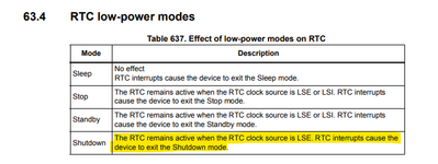

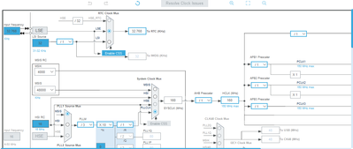

Hello @shivss
Are you using the LSE as RTC clock source ?
According to the reference manual the RTC remain active only when the RTC clock source is LSE.
Saket_Om
 yes am using LSE
