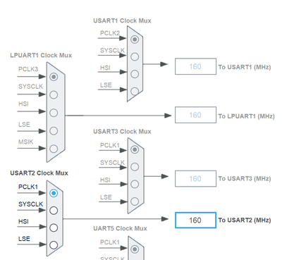

Im not expert to Arduino , but waking support require right clock tree setup for USART and work only on USART, that support it.
default clock is PCLK but this in STOP not clock = no wake. Switch before stop USART used to clock , that run in STOP

This isn't really an Arduino question, I've just cheated slightly by using the HardwareSerial abstraction, but I'll remove that if it makes this thread clearer and just go-to pure HAL.
I have tried changing the clock via HAL but perhaps I've done something wrong there
