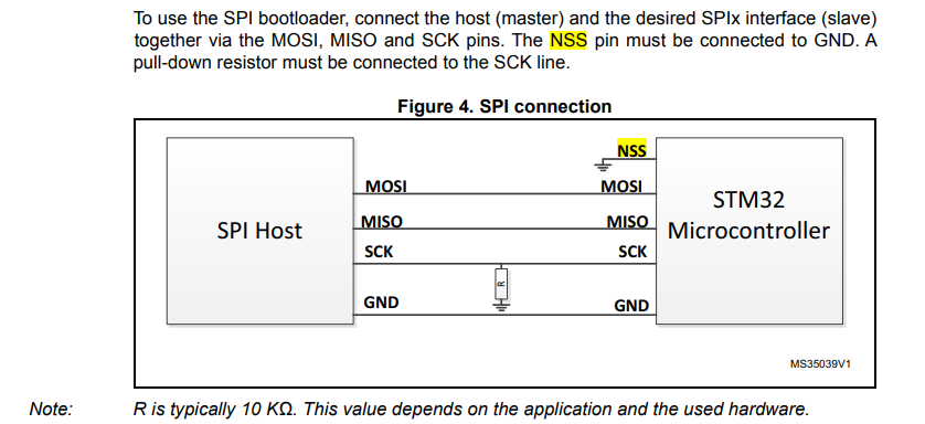

We've nailed down the issue to the bootloader configuring the SPI1 in slave mode, that for our specific GPIO (PA6) is the MISO line. As the SPI1_NSS line was left floating in the design, it the slave is Selected (SPI1_NSS -> LOW), setting SPI1_MISO (PA6) in output-high-level.

A quick check in AN2606, it is precised that NSS must be connected to the ground:
0693W00000LxGFsQAN.pngThis is said, your proposals remain valid & I'll share with our Bootloader Experts.

The bootloader is not supposed to set *any* pin to output (including AF turned to output by the associated peripheral), until the protocol associated with that pin is initialized. In case of SPI, until NSS is pulled down AND master has sent Synchronization Byte (0x5A), as per AN4286.
