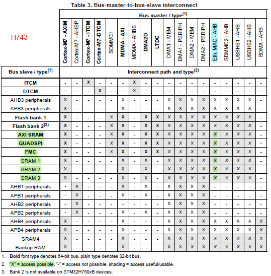

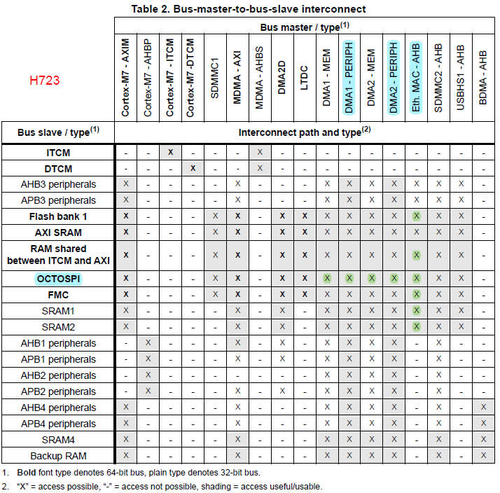

Heyho,
I am really a little confused by ST's documentation vs. comments here and elsewhere, so in hope of finding someone with first hand experience:
Which STM32H7 can use external memory-mapped Octo-/Quad-SPI RAM via DMA with the Ethernet and SAIs ?
My "candidates": H723, H725, H733, H735
H743 & friends has no Q/O-SPI SRAM interface, and if possible I want to avoid the 2-core H7s.
I need this data flow:
SAI (RX) -> DMA -> ext. Q/O-SPI-SRAM -> DMA -> ETH
Thanks in advance!
Best answer by Alex - APMemory
Just general comment about H723, H725, H733, H735. they are supporting OSPI, but have limitation with QSPI SDR (no memory mapped write), QSPI DDR OK. We have confirmed testing APMemory RAM

ETH likely cannot access it. Consider that ETH has its own master DMA, it does not use the DMA controllers of the STM32. See the bus matrix pictures in the RM.

Concerning DMA / memory access:
What about the Dx-to-Dy AHB bridges, these cannot be used by the DMA controllers?
If these are working, are they slowing things down ?
The thing is that the RMs show that access from SAI (DMA2) and ETH DMA is possible, but from users I read differently.
Here's the interconnect matrix for the H723+:
0693W00000WLOlzQAH.pngHere for the H743:

I just started working with:
  • a H735 Discovery Kit with OctoSPI HyperRAM, and
  • some H723 Nucleos + APS6404L which is SDR :(
Within the next few weeks I plan to test these memories with the application mentioned above:
SAI_DMA -> external serial RAM -> ETH_DMA
so I definitely need the memory mapping for writing.
Does AP offer any Quad/Octo SPI DDR RAM ?
Alex - APMemory
January 12, 2023
We are supporting OPI in BGA24/WLCSP, QSPI DDR in WLCSP only and QSPI SDR in SOP8/USON8/WLCSP. You can find most of them at Mouser for prototyping, such as for example : 128Mb OPI BGA24 3V APS12808L-3OBM-BA, 16Mb QSPI SDR SOP8 APS1604M-3SQR-SN. (128Mb QSPI DDR WLCSP 350um pitch APS12804O-DQ-WA is under NDA)
