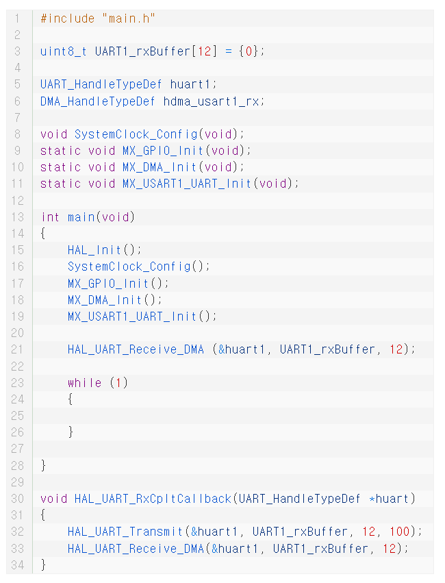

I developed UART by DMA method and it works normally, but I am posting because I have one question.
In the case of the sites I found, most of the main function or initial HAL_UART_Receive_DMA function was called, and the HAL_UART_RxCpltCallback function also called HAL_UART_Receive_DMA. So I also wrote the same.
I thought the reason for doing so was to make the DMA controller listen again. So I thought that the HAL_UART_RxCpltCallback function also calls the HAL_UART_Receive_DMA function.
However, UART works normally without calling HAL_UART_Receive_DMA in HAL_UART_RxCpltCallback. Can you tell me why?

The referenced implementation is:

Are you using circular DMA? What sites have you followed? I recommend https://github.com/MaJerle/stm32-usart-uart-dma-rx-tx

Are you using an ST example?
You can use HAL_UART_Receive_DMA in HAL_UART_RxCpltCallback function to keep receiving data, otherwise you will only receive it once.
Also, you can add a breakpoint in HAL_UART_Receive_DMA in HAL_UART_RxCpltCallback function to stop the program after data is received, and check rxbuffer.
