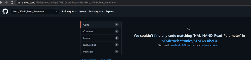

Sorry, I was wrong, I double checked with other colleagues and someone had done custom changes in stm32f4xx_hal_nand.h and stm32f4xx_hal_nand.c, so the files I was looking at were not original ST files. This is now corrected in a new version of the project...
Those changes are not in the GitHub repo, or anywhere else on GitHub.
As for why not everything makes it into the release notes, that's just the way it is and always has been. I would recommend doing a diff whenever you upgrade and upgrade only when necessary and not simply when it's available.
