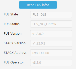

The option bytes are:
and the FUS information is:
We use both the FUS firmware and the stack firmware from stock firmware downloaded by the STM32CubeIDE. The MCU is STM32WB55RGV6.

I do it  in exactly same way as I do with NUCLEO-WB55. I load the FUS v2.0.0.3 in the STM32CubeProgrammer v. 2.20.0 with the "Start address automatic determination" active. With the stack v1.22.0.2 already installed, the programming of FUS returns FUS_STATE_IMG_NO_SPACE. When the stack is deleted, then programming of FUS returns FUS_STATE_IMG_NOT_AUTHENTIC.
I've also tried with the start address 0x080EE000 manually with the same result.
