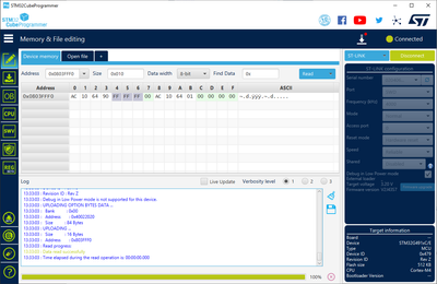

I'm trying to write some data to a address in the flash memory of the above mentioned chip. However the Erase doesn't seem to work.
void writeToFlash(uint32_t address, uint64_t data, uint64_t data2){
	// Unlock the Flash Program controller
	HAL_FLASH_Unlock();
	// Setting Up the Erase
	FLASH_EraseInitTypeDef EraseInitStruct;
	EraseInitStruct.TypeErase = FLASH_TYPEERASE_PAGES;
	EraseInitStruct.Banks = 2;
	EraseInitStruct.Page = 127;
	EraseInitStruct.NbPages = 1; // simple function only sending 8 Bytes at the time.
	uint32_t pageError;
	//Erasing specific part of memory
	HAL_FLASHEx_Erase(&EraseInitStruct, &pageError);
	//Programming the flash, last adress of the second Bank!
	HAL_FLASH_Program(FLASH_TYPEPROGRAM_DOUBLEWORD, address, data);
	HAL_FLASH_Program(FLASH_TYPEPROGRAM_DOUBLEWORD, address + 0x08, data2);
	//Locking the flash back up
	HAL_FLASH_Lock();
In the main I'm calling the following:
writeToFlash(0x0807FFF0, 0x00FFFFFF9A6410AC, 0x00000000016410AC);
The reason I'm specifying the bank and page number is because I (think I,) know where the data needs to be erased.
And when do a full chip erase via STM32Cube Programmer, the writing to the flash works. But when I try to do it with some data storage already in the memory. It doesn't. Please help, I've been struggling now for a couple of days.

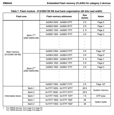

Hello @BAdmi.1,
You are using a G491RC with 256KBytes of Flash size in single bank only.
Dual bank is supported on devices STM32G4x3 Series.

Try just erasing in the program, nothing else; and then read out the erased area using CubeProgrammer - was it erased?
Not when i try it in the second bank, when i run the program for the last page of the first bank. It works just fine:

So my code works when i try it in the first bank, when i try it in the second bank it fails.
Changing banks value to 0x02 doesn't work. But why?

I don't use Cube/HAL, but it's open source, so you can debug it as usually: observe what is written to the FLASH registers, and compare it against the description in Reference Manual.
