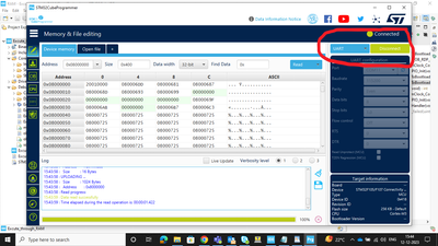

At first, I am able to Jump to internal bootloader while running the application code from SRAM and further able to connect STM programmer using UART interface. At this time the RDP flash protection was not enabled.

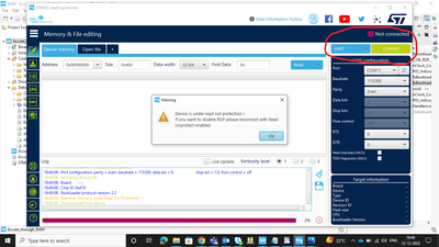

Now when RDP protection is enabled and I execute the same piece of code, I get the following warning.
So, I need to disable RDP protection from the application code before jumping to internal boot loader. For this, I use the below function.

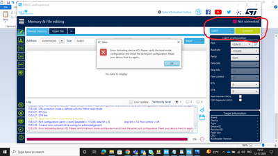

In this JumpToBootloader function, I am unlocking the flash and option byte and making the RDP level 0, it’s not jumping to the bootloader and then it’s showing the error: Activating device KO.
So, please help me out in this how to properly configure the option bytes for the STM32F105 and change the Read-Out Protection feature.
