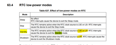

Hello @shivss
The device cannot enter on standby and shutdown mode or cannot exit?
Please refer to the example below:
STM32CubeU5/Projects/NUCLEO-U545RE-Q/Examples/PWR/PWR_STANDBY at main · STMicroelectronics/STM32CubeU5 · GitHub
Note that The RTC remains active when the RTC clock source is LSE or LSI.

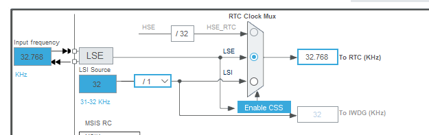

It is not exit from standby and shutdown modes. The example code is using Wakeup pin but want I need is wakeup with RTC .In RTC INIT checking for wakeup same as in example . This code is working for sleep,stop1,2 and 3 the RTC is working fine  with these modes but not for standby or shutdown even UART messages are also not printing after standby or shutdown
static void MX_RTC_Init(void)
  /* USER CODE BEGIN RTC_Init 0 */
	uart_send("RTC start\r\n");
	// Check if waking from Standby — if yes, skip full init
	  if (__HAL_PWR_GET_FLAG(PWR_FLAG_SBF) != RESET)
		  uart_send(">> Woke from STANDBY\r\n");
	      __HAL_PWR_CLEAR_FLAG(PWR_FLAG_SBF);  // Clear standby flag
	      HAL_RTCEx_DeactivateWakeUpTimer(&hrtc);

Hello @shivss
Could you please ensure that the RTC wake-up timer interrupt is properly configured by adding the following functions ? Once done, kindly let us know if the issue persists:
  /* Enable WakeUp line functionality for the RTC ALARMA */
  HAL_PWR_EnableWakeUpPin(PWR_WAKEUP_PIN7_HIGH_3);
  /* Enable the Autonomous Mode for the RTC */
  __HAL_RCC_RTCAPB_CLKAM_ENABLE();
