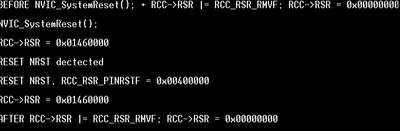

Im beginner,
STM32H753 on the EVAL BOARD,
Objective:
At startup, the IAP is ignored with a condition on the jumpToIAPFlag flag that checks whether the reset is related to POWER ON or NRST (hardware button), which would therefore be a normal startup. The flag is then initialized to 0 and we jump directly to APP.
Once in my APP, I want to be able to return to the IAP (by reading a bit on frames). At first, I did the same as for jumping from IAP to APP, but in the end, a soft reset should be enough for the jumpToIAPFlag to remain at 1 and not pass through the POWER ON or NRST reset conditions, and therefore my IAP menu should open.
Everything related to frame logic, etc. is functional, but my APP to IAP no longer works since I started using a variable (jumpToIAPFlag) that is common to both my IAP and my APP.
The result is that when I send the frame to open my IAP, there is indeed a reset, but my IAP does not launch. Instead, my APP launches as if my jumpToIAPFlag value had not been saved in memory.
I added a small shared memory area like this (in both FLASH.ld): IAP :

and then I declared the flag in both projects like this :
 __attribute__((section(".noinit"))) volatile uint8_t jumpToIAPFlag;
I then trigger the reset + flag = 1 here (commenting out the old method with a jump) :

	if ((FrameS2C[1] & 0x08) == 0x08)
		// Si bit 3 de l'octet 1 vaut 1 alors jump to IAP
		// on signale qu'il y a une demande d'IAP
		jumpToIAPFlag = 1;
        // Reset logiciel pour relancer le micro et démarrer IAP
        NVIC_SystemReset();

  SCB->VTOR = IAP_ADDRESS;
  /* USER CODE END SysInit */
  MX_GPIO_Init();
  MX_USART1_UART_Init();
  /* USER CODE BEGIN 2 */
  // au premier démarrage il faut forcer le flag jumpToIAPFlag à 0 pour jump à l'app
  // on regarde dans le registre CSR qu contient le flag pour savoir comment le dernier reset à été déclenché
  // on compare avec les bits des reset par NRST hardware et POWER ON et on laisse passer le reset via soft (swap IAP - APP)
  if (RCC->RSR & (RCC_RSR_PORRSTF | RCC_RSR_PINRSTF)) {
	  jumpToIAPFlag = 0;
  // on nettoie les flag de reset
  RCC->RSR |= RCC_RSR_RMVF;
  // meme chose avec macro HAL
  //__HAL_RCC_CLEAR_RESET_FLAGS();
  if (jumpToIAPFlag == 1)

jumpToIAPFlag in APP project before NVIC_SystemReset(); = 1
jumpToIAPFlag in IAP project BEFORE reset flag check = 111
if (RCC->RSR & (RCC_RSR_PORRSTF | RCC_RSR_PINRSTF) = IN
jumpToIAPFlag in IAP project AFTER reset flag check = 0
So the flag is set to 1 when I receive the frame for IAP and the reset is performed correctly.
Problem 1: the flag value is not saved (“jumpToIAPFlag in IAP project BEFORE reset flag check = 111”)
Problem 2: I performed a software reset, but I still enter the loop conditioned on the POWER ON and NRST reset flags ("if (RCC->RSR & (RCC_RSR_PORRSTF | RCC_RSR_PINRSTF) = IN), so the flag is set to 0 --> I go straight back to my APP and my IAP manual is not displayed.

HugoSTM32
Just for the second problem, I now understand why I was still getting into the :
This is because when a software reset is triggered, the microcontroller simulates an NRST reset. Here is some print:
After my NVIC_SystemReset();
I read the RSR register and notice that other flags are set to 1, RCC->RSR = 0x01460000
bit 17 : CPU reset
bit 18 : reserved
bit 22 : NRST reset
bit 24 : Soft reset
