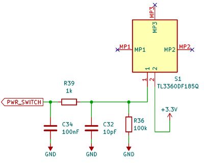

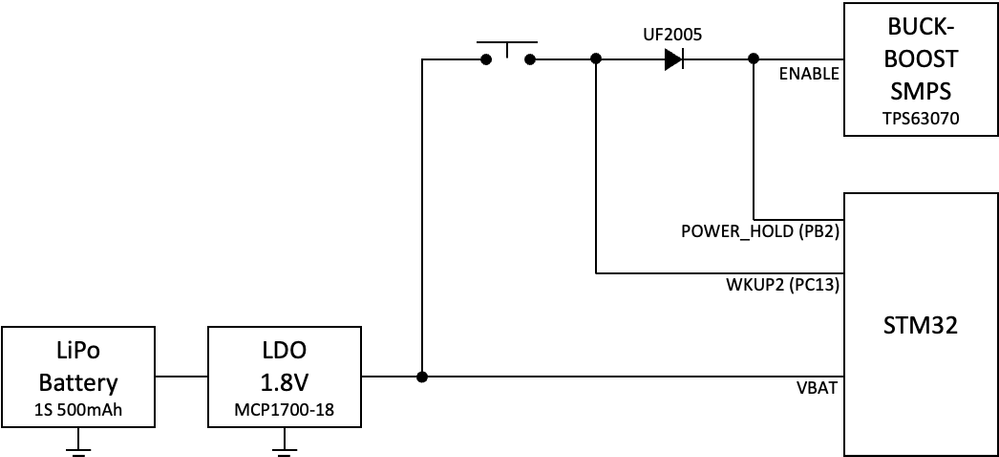

1. The WKUP2 pin currently uses the 3.3V from the buck-boost converter (I copied the same circuit used on the Nucleo develpment board).  But if I disable the buck-boost converter then there will be no 3.3V supply to the switch for the WKUP pin, so the STM32 would never wake.  The circuit is shown below..

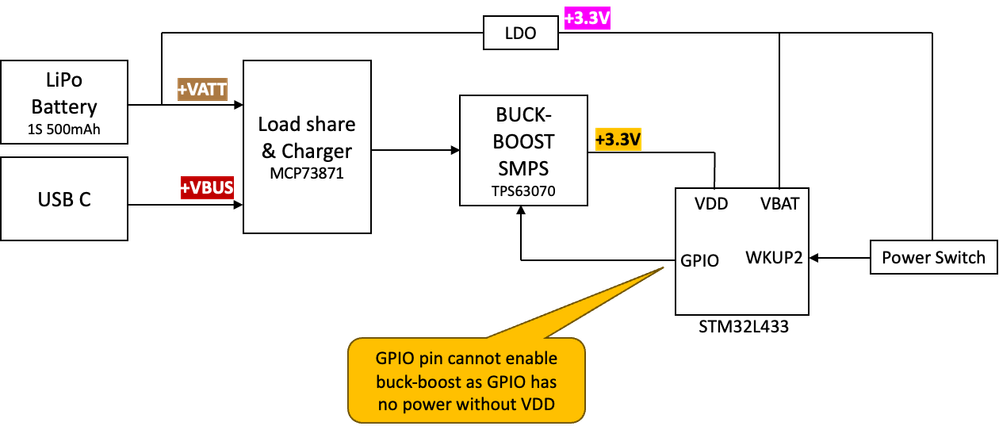

This is the issue I have, its a chicen and egg situtation
To enable the 3.3V buck-boost converter, the STM32 needs to set the GPIO pin high.
However, if the STM32 is only powered by the VBAT pin, then the GPIO pins are not powered so the buck-boost converter cannot be enabled.

I have just implemented the following circuit so I can disable the 3.3V buck-boost converter...
When the button switch is pressed....
  • The 3.3V buck-boost converter is enabled
  • The STM32 is woken
  • The STM32 power hold pin is set high
    • This is to keep the 3.3V buck-boost converter enabled when the push button is released
During shutdown/standby....
  • The 3.3V buck-boost converter is disabled
  • The STM32 VBAT pin is powered by the 1.8V LDO regulator
I had to use a regulator and diode that I had lying around, so there are probably more low power versions I can use, but I just wanted to check the method works.
