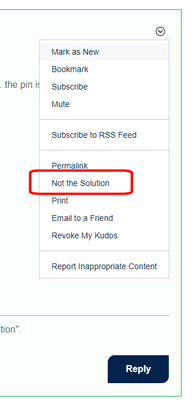

You have to un-mark one before you can mark a different one
Clikck on the AndrewNeil_3-1708356226886.pngin the top-right of the post:
Then choose 'Not the solution':
#UnmarkSolution
