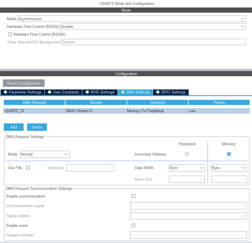

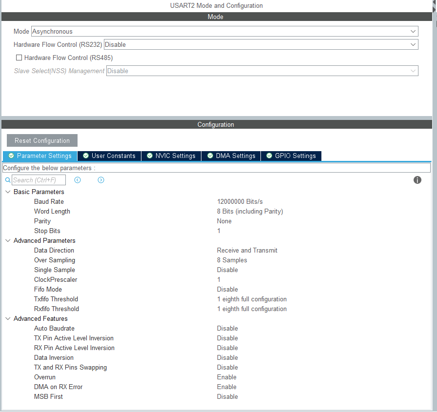

I'm trying to enable USART transmission (TX only for now) via DMA, but when I call HAL_UART_Transmit_DMA, the transfer doesn't seem to start at all and HAL_UART_TxCpltCallback is never called.
I've configured everything through CubeMX: enabled USART with DMA, enabled FreeRTOS, and enabled interrupts. Without DMA, transmission works fine using HAL_UART_Transmit, but when I switch to HAL_UART_Transmit_DMA, nothing happens.
I can't figure out what the problem might be. Does anyone have any suggestions?

Okay, there is the issue: you need to use the MPU or do proper cache maintainance, I would go for the MPU.
https://community.st.com/t5/stm32-mcus-embedded-software/adc-dma-on-stm32h753zi/td-p/856589
The MPU should define a memory region which is sharable and non-cacheble, then you set via the linker file a region to a specific andress, which matches the region configured by the MPU. Then you can place your buffer there.
8 REPLIES 8
Vidar
Are your DMA buffers in non-cacheble regions? Can you share your MCU, .ioc and MPU config?
MCU: STM32H753ZI (NUCLEO-H753ZI board)
I'll attach my .ioc file.
Regarding MPU config: MPU NOT USED

I looked at the two examples you sent me, but the first one configures everything manually in code without using CubeMX—I haven't tested it yet but I will—while the second one only configures DMA for RX and doesn't set anything I haven't already set. I double-checked my code, removed FreeRTOS in case that was the problem, and also tested sending via interrupt with HAL_UART_Transmit_IT and it works. The only thing that's not working is DMA. I'm new to the ST environment and I'd like to understand if I'm missing something in the CubeMX configuration.
Thank you so much! I think that was exactly the problem. I enabled the MPU and now I'm able to send data. Now I need to try receiving, but I don't think I'll have any other issues. I understand how it works now. Thanks again for now!!!
