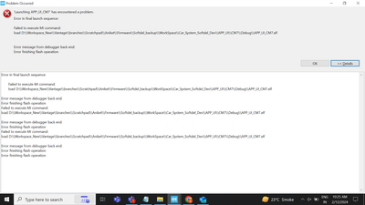

I am writing to address a concern regarding the QSPI External Flash Loader that I have developed, which I have attached below for your reference.
The functionality of reading, writing, and erasing operations with the ".stldr" file in conjunction with other project files is working seamlessly. However, I am encountering an issue when attempting to verify the data during the loading/debugging process.
I would greatly appreciate your assistance in resolving this matter. If there are any insights or suggestions you could provide to help rectify this issue, it would be immensely helpful.

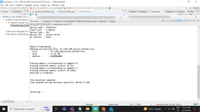

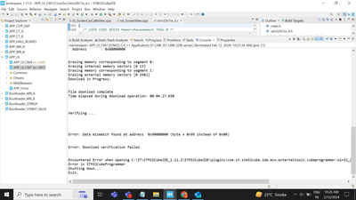

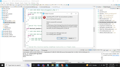

I am Using "Winboard 25Q512JVEQ" foe external memory .
Please Find Attached Snap shot while i am verify.
1) This Image is related to Verification start process
2) After Verification I am getting error message
4) Verifications failed console message

Hello @APate.18 ,
Could you please verify the device size and the programing page size settings.
Also I advise you to check the Debug configurations as mentioned in UM2609 section 3.1.4.1 Debug using the ST-LINK GDB server section.

What exactly is happening with the Verify?
It's supposed to allow for a  quick read-back check for data already in RAM for the purposes of Write to ensure the data was in fact written correctly, and if not, where it failed.

A data shift can be seen if the address width or dummy cycles are in disagreement. Repetitive nibbles would suggest the command is not supported in the current mode.
An illustration of what was written and what's read back would be instructive.
