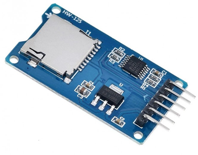

I would like to make an application to access micro sd card via SPI from STM32F407VG-DISC1 board. I have configured the pins as seen in table below.
Main file is also attached.
However, when I run the application I get FR_NO_FILESYSTEM error. My card is formatted as FAT32. It is class4 2GB micro SD card.
When I remove the SD card then I received another error that is FR_NOT_READY. So, this got me thinking that, I have made proper connections, but there is problem with the code.
Could you please point me to the right direction ?
STM32F407VG-DISC1HW125 SD CARD MODULE
PC2 MISO PIN
PC3MOSI PIN
PB10 SCK PIN
PB12 GPIO_OUTPUT
GNDGND
5VVCC
Hi @Andrew Neil
I came to know that SD Card needs some to settle. So, the only I have done is that, I added some delay before mountin the SD card as below. Hope it helps.
Not necessarily.
The card present/not-present might just be detected on a switch ...
Have you tried tracing back to where the error is actually raised?
Do you mean one of these?
Do you have a link to its datasheet?
Thanks Andrew.
Yes, I use one of those. I searched but cant find the datasheet.
I ve debugged the code, please see the attachment. This is where code returns no file system.
If you can't find a datasheet, how can you be sure you have the correct connections?

Hi @Andrew Neil
Thanks.
It would be better to mark that post as The Solution.
