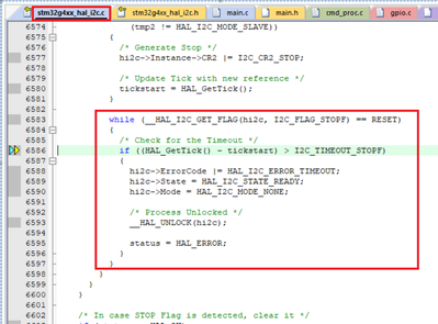

Hi there,
I drove 4 SHT4x by STM32G473VE and used the HAL_I2C_Master_Transmit() and HAL_I2C_Master_Receive() to write and read the sensors.
Normally, everything is well.
However, if I
  1. unplug the sensor;
  2. replug the sensor again;(Not the sensor maybe can NOT work normally)
  3. reset the MCU;
the program will probably run into  the following dead loop:
I don't know why this happened, and how I can recover from this error state.
Thank you!

Hello @Junde
Have you tried checking the device with the HAL_I2C_IsDeviceReady() API after unplugging and replugging it?
Could you provide the data transmission trace using the logic analyzer?

Previous discussion on recovering from problems on the I2C bus:
https://community.st.com/t5/stm32-mcus-embedded-software/hal-i2c-geterror-reporting-error-codes/m-p/677103/highlight/true#M47943
