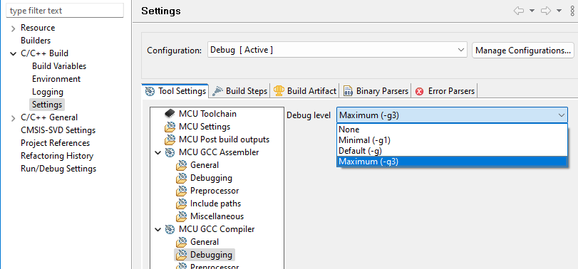

When I builed the project, I had seen the Hal drivers files links in the end file *.HEX.
How can I change the project configuration not to put this links in file because it use flash memory unnecessarily ?
Thanks
Best answer by Andrew Neil
You can get rid of it by not defining USE_FULL_ASSERT .
Or you could change your assert_param definition to not use __FILE__ and, thus, not require that the filenames be stored.

Hi Andrew,
I have -O1 optimisation and your configuration setting.
I give an example of my end Hex file :
0x8005FD0 ........../Drivers/STM32G4xx_Hal_Driver/Src/stm32g4xx_hal_wwdg.c .....
This link in hex file isn't necessarily...

FredoliveAuthor
September 23, 2024
If Debug level is different of "None" then these roots filenames are in rom flash.
The only solution is the "None" choice to have any root filename.
Andrew Neil
September 23, 2024
What do you mean by, "Debug level" ?

FredoliveAuthor
September 23, 2024
Yes, it is rigth. But it used rom flash to anything.
Andrew Neil
Andrew NeilBest answer
September 23, 2024
