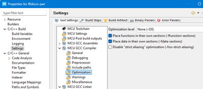

What optimisation level are you using?

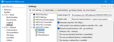

By default, 'discard unused sections' should be enabled - so unused functions shouldn't appear in the final image.
Hi Andrew,
I have -O1 optimisation and your configuration setting.

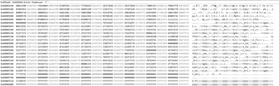

I give an example of my end Hex file :
0x8005FD0 ........../Drivers/STM32G4xx_Hal_Driver/Src/stm32g4xx_hal_wwdg.c .....
This link in hex file isn't necessarily...

You mean your ELF file? The Hex file wouldn't have any symbol information...
I have this links in Hex file
How do you determine that they are actually in the Hex file?
Again, the Hex file contains no symbol information - it is purely code - so where are you seeing that?
This is my hex file for my application.
You look the links file at the end file Hex
