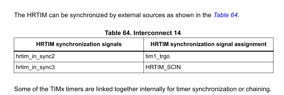

I wanted to generate without Phase shifted PWMs between HRTIM  and Tim1 .
How can I do it? thanks for your support!

Start PWM on TIM1. Then, after a small delay, start PWM on HRTIM based on how much delay you want.

 could you pleae to provide the download link for the document?
Look for Reference Manual RM0440
