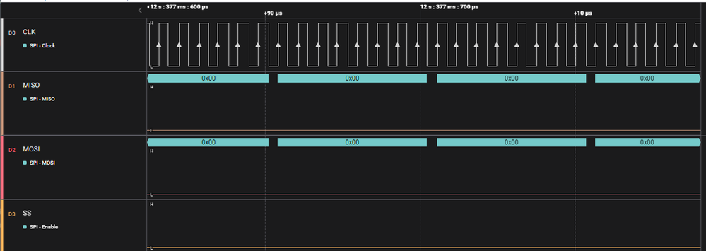

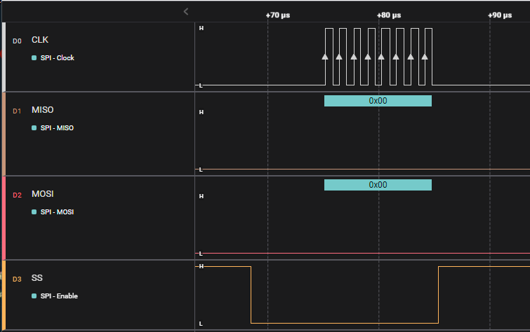

Hope all is well. I am trying to setup a basic SPI demo for the STM32H753ZI using the nucleo H753ZI just seeing if I can output my test word onto the MOSI line.
The conditions in my SPI demo is as follows:
- MCU clocked at 400MHz
- SPI is set as Full Duplex Master
- SPI Clocked at 400MHz/256 = 1.5625MHz approx
- PA4 = SS, PA5 = CLK, PA6 = MISO, PA7 = MOSI
- Theres no slave on the otherend just hooked up to the Salae logic Analyzer
The issues I am seeing is that My SPI demo and STs theres no data on the MOSI line additional to that the CLK is behaving super weird in my SPI demo. You can see boths STs and My SPI demo down below from the logic anayalzer

My SPI Demo
STs SPI Demo

Hi @Community member​, I got it working it was due to the Nucleo reserving PIN PA7 for ethernet. Just swapped onto SPI2 and now I am seeing data on the MOSI line.
