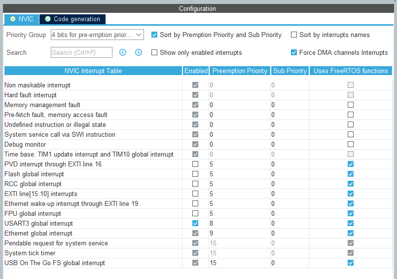

I develop a FreeRTOS / LwIP based application which throws a configASSERT error because of a bad priority.

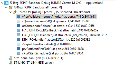

Only when the Nucleo is connected to the LAN, the debugger gets stuck at:
Line 744 of port.c (FreeRTOS source)
configASSERT( ucCurrentPriority >= ucMaxSysCallPriority );
Trace (see image below):
The origin of the interrupt is the ETH_IRQHandler() respectively the HAL_ETH_RxCpltCallback()
I have been searching for this issue and understand that it has something to do with interrupt priorities. Why does this error occur? As I see it, the function call causing it is auto generated by HAL or implemented in the CMSIS source (osSemaphoreRelease).
Can anyone give me a hint where to change something?
There are a dozen different priorities in the STM32/FreeRTOS System, which one do I need to change to avoid this assertion fail?
NVIC Interrupt Priorites are all below the RTOS max of 5 (see image below)
Changing then does not change the configASSERT error.
I am referencing this solution from 2018 which shows the exact same behaviour with the Ethernet connector. However, in my case the ETH Interrupt Priority is already at 9 (lower priority).
https://community.st.com/s/question/0D50X00009XkgpUSAR/problems-with-isr-priority-and-ethernet-stm32cubemx-freertos-lwip-

As can be seen from the call stack, the scheduler is started,
