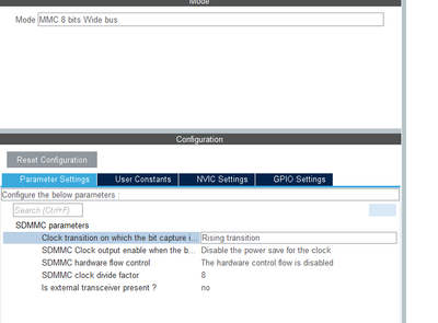

The .IOC file is all standard:

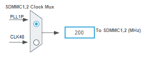

with the clock config as follows:

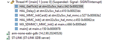

However, when I start a debugging session I get stuck in the init function like so:
It looks almost like the sysTick is not being updated at this point so the whole init just stalls.

Look at the code where it's paused and why it's stuck there, in HAL_MMC_InitCard. The issue is probably not HAL_Delay directly but rather *why* it's waiting. The generated code probably expects an MMC card as opposed to an eMMC chip. There are subtle differences.

I have removed TouchGFX and FreeRTOS and got the init function to work with first 1-bit MMC and later 8-bit wide MMC. adjusting the clock division to 12 helped.

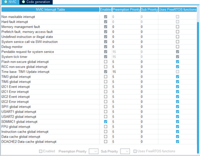

I've added the FreeRTOS wit just a simple blink statement. That works just fine. Any suggestions to the interrupt priorities I should try out?

I changed the priority of the TIM1 to 0 and now the MMC initializes, the RTOS is running and TouchGFX is showing images :)
