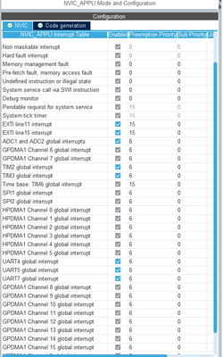

I'm working on an STM32H7RS project (NUCLEO-H7S3L8) with the following setup:
  • Bootloader in internal flash (0x08000000)
  • Application in external OSPI flash (XIP) at 0x70000000
  • Using FreeRTOS
  • Using TIM6 as the HAL time base (not SysTick)
  • Configured using latest STM32CubeMX and STM32CubeIDE (v1.18.1)
My current issue is that while HAL_Delay and TIM6 is working, SysTick seems not to work inside of the RTOS as soon as the scheduler starts.
I noticed that because ther CPU got caught inside osDelay without throwing an error.
I also already checked the NVIC, but it seems pretty fine to me. Did i otherwise miss something what i configured wrong inside my IOC file?
It seems to be that SysTick_Handler() is not beeing called by the FreeRTOS.Is that a problem with the NVIC?
EDIT: This is the solution, to set all the interrupts which are not 0 or 15 to something above 5 in my case, it may vary depending on your FreeRTOS configuration.

Is the systick interrupt happen?
Saket_Om
Yes, when in debugging, i inspected the SFRs. After every step the value of STCVR changes, which would indicate for me that SysTick is behaiving normal and the interrupt happens.
But i dont know if that still is the case when the Scheduler starts, as CubeIDE doesnt allow you to live debug the RTOS app.
Hello @htxy
Could you please check if the SysTick_Handler() is being called by setting a breakpoint when Scheduler starts ?
Saket_Om
