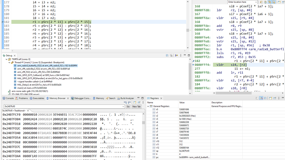

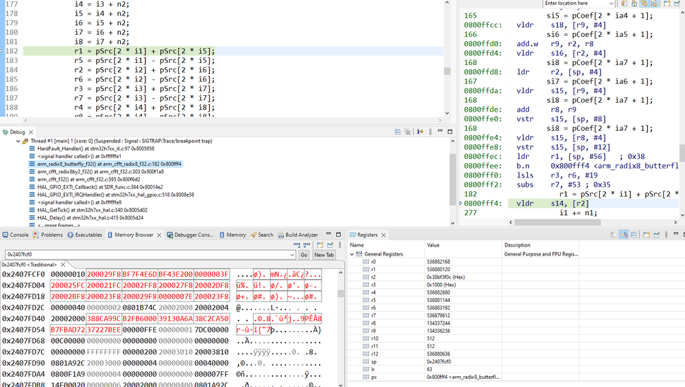

For now please have a look at these screenshots, The first is after placing a breakpoint on the one and only line that sometimes triggers the Hardfault.
The second is taken after a Hardfault. As you can see sp is the same, the stack looks OK, r2 is loaded at 0x0800ffd8 but something happens before reaching 0x800ff4.
Since r2 is, as brilliantly pointed out, automatically saved in ISRs, the only way to achieve this I can imagine is that in some way there is a jump from somewhere landing exactly there, and the ldr r2 line is never executed. Hard to believe because, apart from this hardfault, the board performs normally, and by patching with push or shuffling the code it runs forever.

I don't understand the second screenshot: is this something resulting from "walkback"? I don't use Eclipse. Show us content of registers, stack, disasm at the hardfault.
