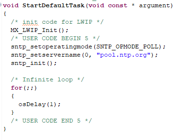

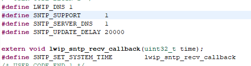

Now i am using STM32h747 for get time from NTP server
0693W00000aJb8TQAS.png0693W00000aJb8YQAS.pngIt working well with DHCP config, But when I config Static IP and can't access NTP server
can anyone help me with this. Thanks
1 REPLY 1
Bob S
When using DHCP, what are the IP address, netmask and default gateway that you get? And when you use static IP, what IP address, netmask and gateway are you setting?
