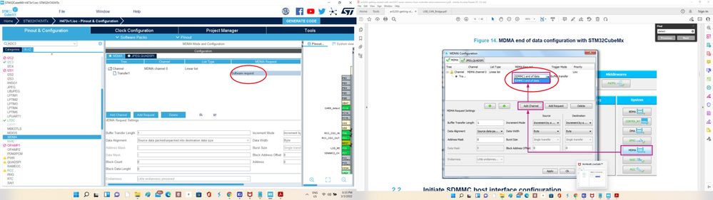

Configure SDMMC2 for H743VIT6
ksale.1
Senior
1- How do I let CubeMX know the SD pin detect, I've set pin PC13 as card_detect, GPIO input, pull-up, but then what?
2- Should I use the open source FATFS "https://elm-chan.org/fsw/ff/00index_e.html"? How?
Thank you
Bouraoui Chemli
Please refer to AN5200 Getting started with STM32H7 Series SDMMC host controller.
Also, you can refer to the provided example which perform some write and read transfers to SD Card with SDMMC. Available in STM32CubeH7 firmware via this link
STM32Cube\Repository\STM32Cube_FW_H7_V1.xx\Projects\STM32H743I-EVAL\Examples\SD\SD_ReadWrite_IT
Bouraoui

mƎALLEm
Please refer to this video from Youtube: https://www.youtube.com/watch?v=I9KDN1o6924
Thank you @Bouraoui Chemli​ ,
Please note the slight difference between AN5200 MDMA config and my CubeMX MDMA, as shown in figure below:
0693W00000KbJifQAF.jpgBR
Thank you @Community member​ ,
Very helpful.
